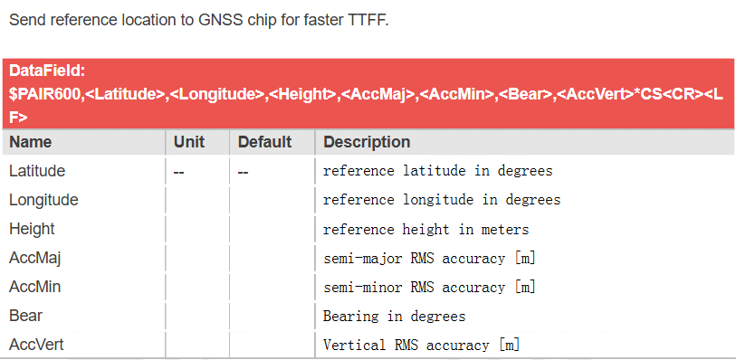

Hello, the airoha chip can achieve a cold_ fix in 26s (but with a good antenna!), there are some agnss for f.ttf but need to inject…
the pair064 is not for, instead there is (but not fw compatible)

thank you for your response <
is it possible for a warm start with out the backup power and with the EASY
Think no,but ask it also in the post for new fw…
