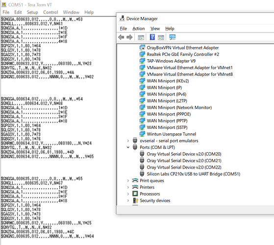

As I tried,
by default we can see the NMEA log from the GNSS port.
The default baudrate is 921600.
But you cannot send the AT
AT+QGPS=1
Hi @Bean.Wang-Q ,
We confirmed it is a hardware issue and the GNSS console should be on and emit messages by default
Thank you for your help to test
