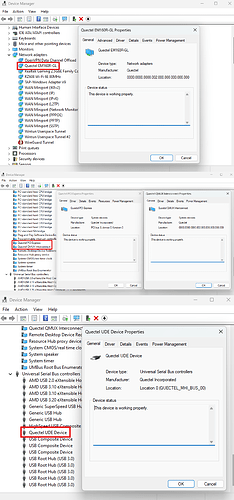

When checking the device manager, I see the following devices:
  • Network Adapters:
    • Quectel EM160R-GL
  • System devices:
    • Quectel PCI Express
    • Quectel QMUX Interconnect
  • Universal Serial Bus Controllers:
    • Quectel UDE Device
Since the device is showing up under Network Adapters, I think it’s safe to say that the connection is made, just no communication possible.

You can show the device manager.

I have attached screenshots of the four devices I can see listed in device manager. These all show up when running the driver installer with the Setup.bat file.
As mentioned previously, when manually only installing the drivers from the PCIE folder individually, these devices are not shown, instead a Quectel Modem Host Interface group with the Quectel PCI Express device is listed, though also without open ports.
