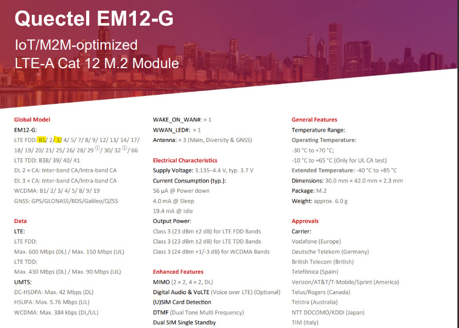

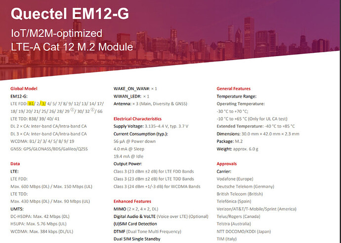

Hi @yuretzkin
EM12G can works in band B3 and B1 . Please refer to below screenshot on the specification document:

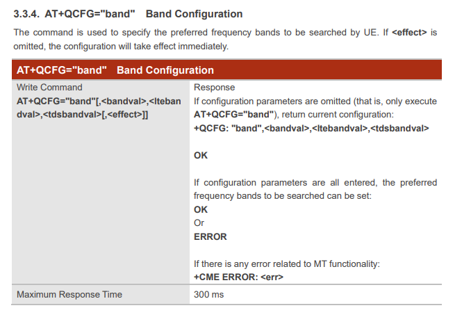

You can use the AT command AT+QCFG=“band” to lock on the preferred band
