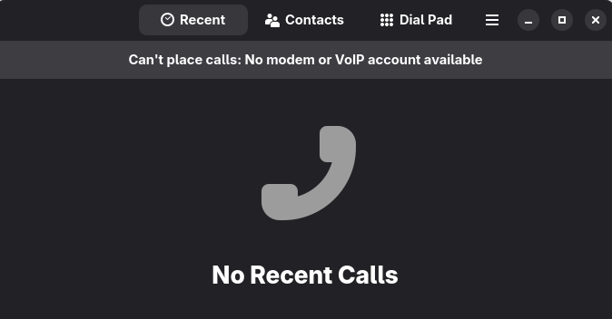

EM061K-GL calls not available
How to enable on Linux? Kernel is 6.16.4

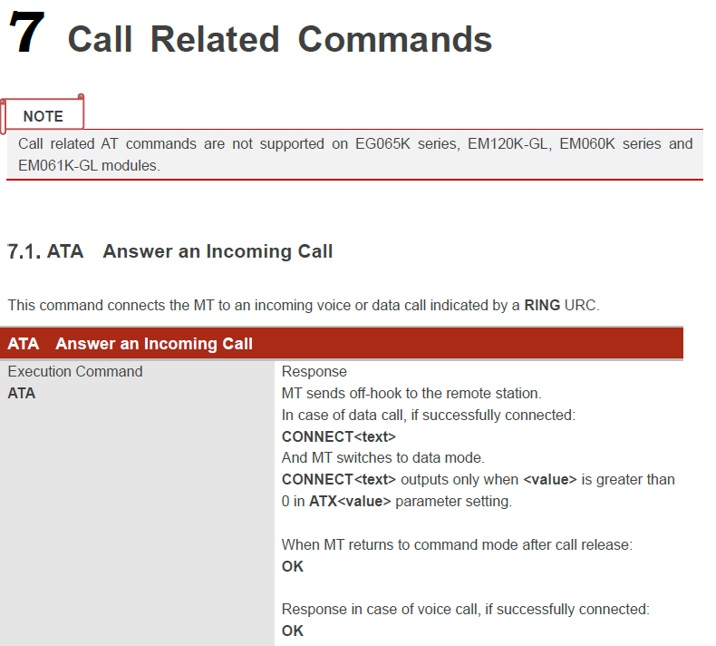

You can check the document.
quectel_eg06xkex120kem06xk_series_at_commands_manual_v1-0.pdf (2.1 MB)
