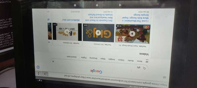

Now i can able to access the cellular data , but iam facing inconsistency in network connection (network is working only for few seconds after network automatically disconnected ).
please find the attached debug prints .
Best Regards,Android_Debug.pdf (131.1 KB)
