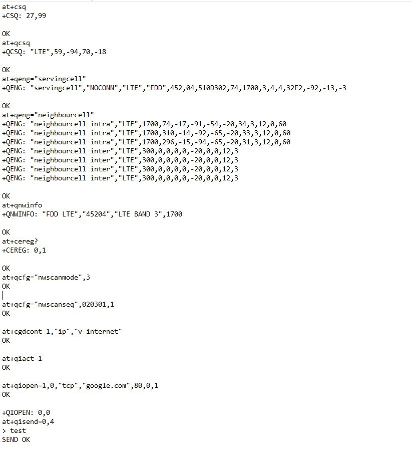

  • AT Commands Used:
    • AT+CSQ → +CSQ: 27,99
    • AT+QCSQ → +QCSQ: "LTE",59,-94,70,-18
    • AT+QENG="servingcell" → Signal RSRP: -92 dBm, RSRQ: -13 dB
    • AT+QNWINFO → "FDD LTE", "45204", "LTE BAND 3", 1700

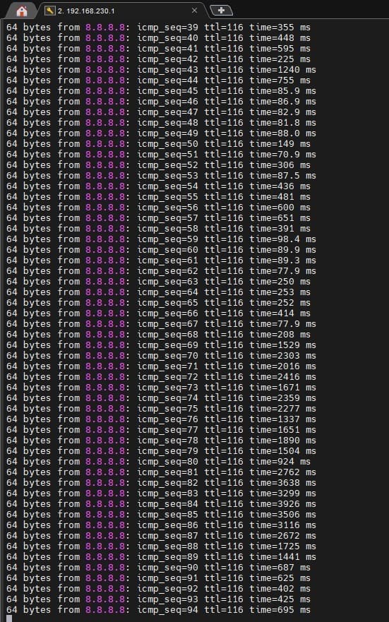

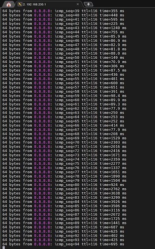

  • The ping test shows frequent latency spikes >2000ms, sometimes >3000ms (see screenshot).

Hi @Long_Ph_m_Van
I noticed in QENG’s return data that the SNR was very poor, at -3. This indicates the presence of downlink interference, which could be inter-cell co-frequency interference within the network, or external interference. This cannot be confirmed. I think switching to a card from a different operator might work.
