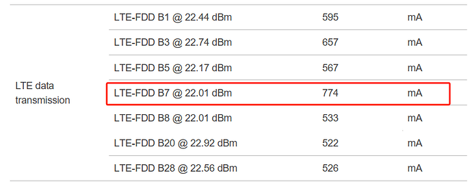

The Hardware Design doc specifies a typical current of 774 mA (LTE-FDD B7 @ 22.01 dBm), which appears to be the highest typical value listed. However, it also states that the power supply should support peak currents of up to 1 A on VBAT_BB and 2.5 A on VBAT_RF. Can we assume these peak values are primarily associated with GSM voice call modes—could you please confirm whether similar peaks may also occur during LTE data transmission, particularly under poor signal conditions or high throughput?

The data indicated in the figure merely represents the average power consumption tested by the modem connection test instrument,It is not the peak current or power consumption;It is suggested that you refer to the maximum peak current of 1A
