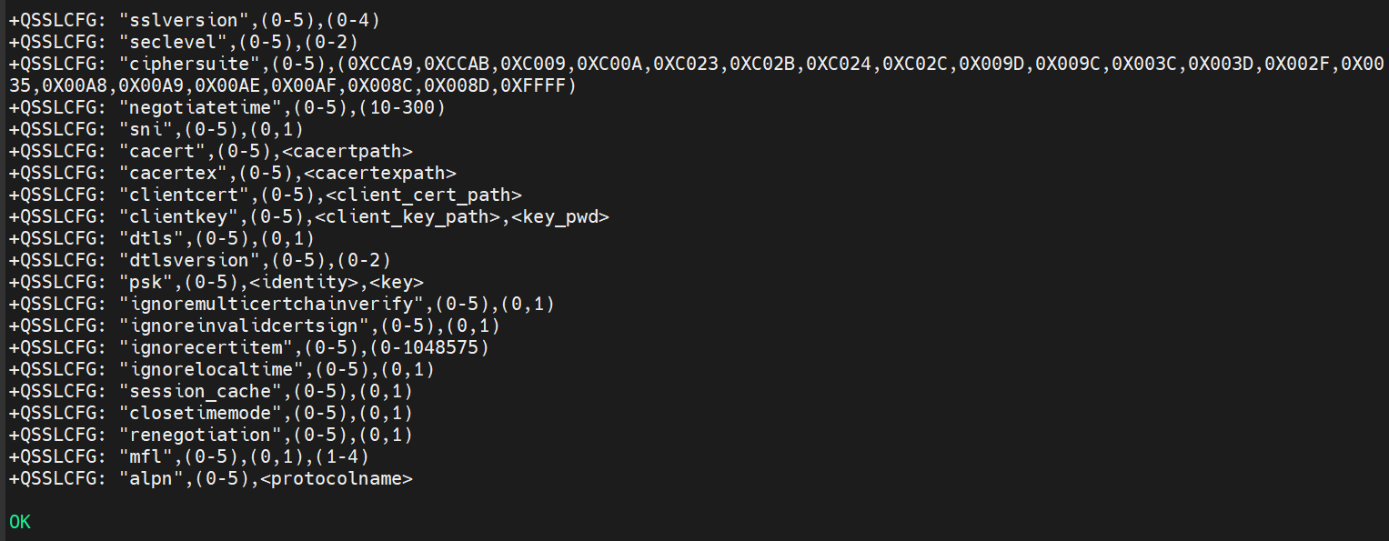

Thank you very much for your detail description. After executing AT+QSSLCFG=?, we get following output:
There is one thing that we need to verify. For SSL context ID, the context ID range is 0–5. Which one should I use(you use context ID 1), or can I freely assign any context ID within this range in the SSL parameter configuration? Thank you.

Dear @WangNan ,
Thank you for sharing the AT+QSSLCFG=? output.
Based on your output, each AT+QSSLCFG parameter is defined with an SSL context ID range of 0–5 (for example, “sslversion”,(0–5), “seclevel”,(0–5), “cacert”,(0–5), “sni”,(0–5), etc.). This means you can choose any context ID within 0–5 for your SSL parameter configuration.
Please select one context ID (for example, 1) and then apply all required SSL settings using that same ID consistently (cacert path, seclevel, sslversion, ciphersuite, ignorelocaltime, and other items you need).
