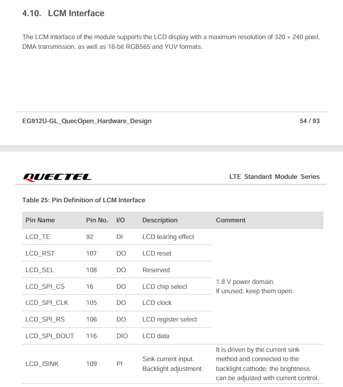

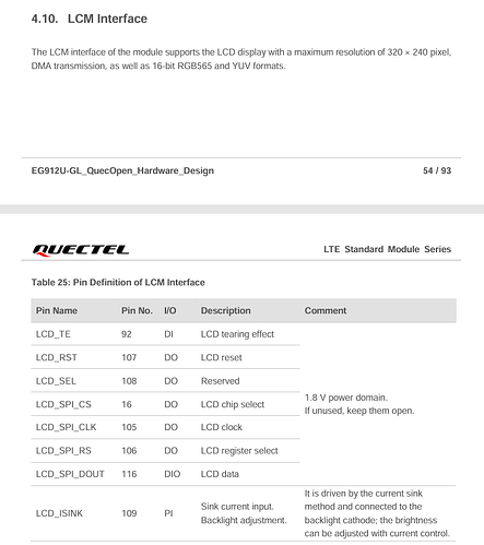

I’m wondering what the differences are between the GLAA and GLAC variants (it appears that the GLAA supports GNSS and the GLAC does not), and if the GLAA supports SPI. I would like to use to drive an LCD from QuecPython. Please let me know if this is correct or if I need a different module to do both GNSS and LCD.
