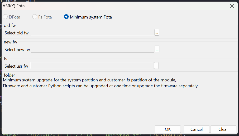

I would like to study the FOTA feature on EG800K-CN with the QPY OCPU firmware available on the download zone.
I’m currently following the documentation: fota - Firmware Upgrade - QuecPython and had discussion with Qchat about the feature. I also saw Firmware OTA Delta Package Making Guide - QuecPython but it seems it’s not applicable for EG800K as I tried the MiniFota process and bricked it in the mini-system with the faulty process (luckily i am able to reset it with USB_BOOT). The conclusion i had with Qchat is that i can only do full firmware package FOTA via QPY
I would like to know if anyone had experience in this situation, and if there are any simple example that is applicable in my situation i can follow.
