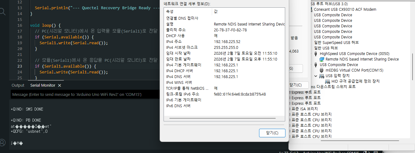

Hello, oneday my quectel module shows only DM port or RNDIS mode.
Even my module’s “usbnet” is set on 0, reflashed firmware, used AT+QPRTPARA=3.
Module seems not broken, because everything without usb conns are working. (ims, ata, ath, RING from UART)
can i get some help with this?
