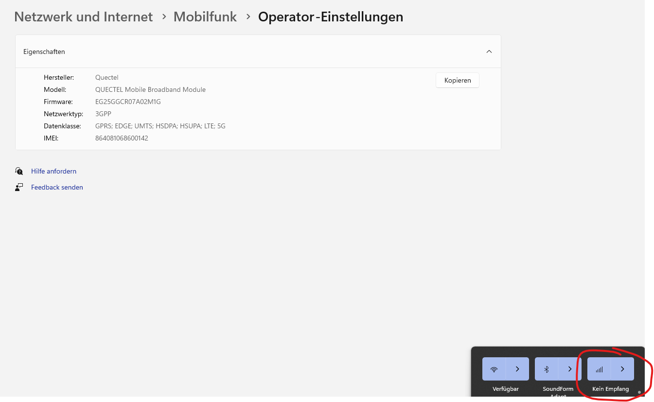

I have a new device with a Quectel EG25-G Module in it.
And it only shows “no services” and i am not even able to put APN Settings or anything.
The inserted SIM Card also got not shown.
here the information i got from the device. What can i do?
|Hersteller:|Quectel|
|Modell:|QUECTEL Mobile Broadband Module|
|Firmware:|EG25GGCR07A02M1G|
|Netzwerktyp:|3GPP|
|Datenklasse:|GPRS; EDGE; UMTS; HSDPA; HSUPA; LTE; 5G|
|IMEI:|864081068600142|
