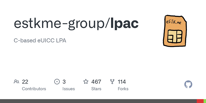

I had luck with consumer eSIM (5ber) using EG25-G.
I had to run on the host following service with QMI-backend
Try to use previously activated eSIM first.
