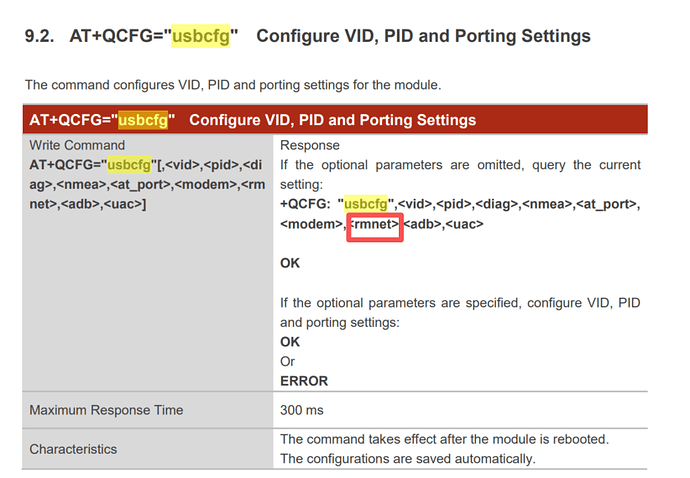

Even though you want to set the modem to ECM mode, the bit rmnet must be 1.
Please try
AT+QCFG=“usbcfg”,0x2C7C,0x0125,1,1,1,1,1,0,0
As long as you need the usbnet feature such as rmnet/ECM/MBIM/RNDIS, the fifth bit must be 1.
