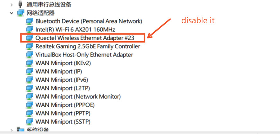

Was network registration status good when you executed AT+QFOTADL command? Did you perform the test in Windows or Linux? If in Windows, Quectel wireless network adaptor has to be disabled:
