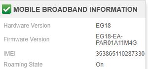

The LTE-Modems IMEI is: 3538 6511 0287 330
For the installation process is there anything I have to keep in mind if I will change (or already have changed) to Voxel’s firmware? The latest release there is just ~3 weeks old, so really up to date!

Therefor I want to ask, if there is still any chance for me to update my module from version 11 to version 13.
Even more important: Can anyone please provide an (detailed) update guide for how to install the file(s) in the zip?

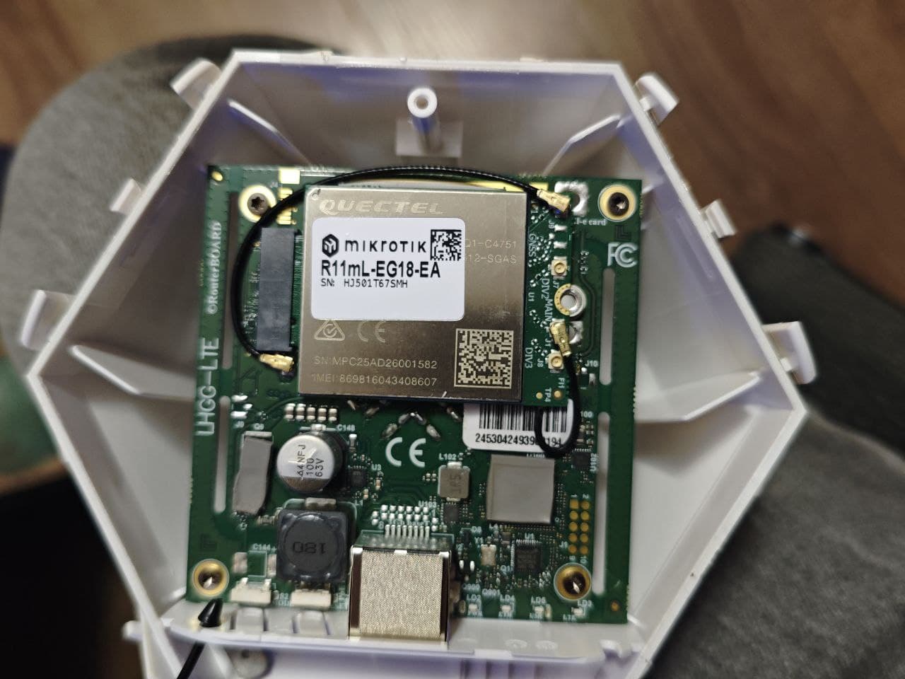

Hi, can you please provide the latest firmware for my EG18-EA? Here is the result of the ATI command:
Hi, can you please provide different firmware versions 12 for my EG18-EA? Here is the ATI command:
ATI
Quectel
EG18
Revision: EG18EAPAR01A12M4G
OK
he is in Mikrotik LHG LTE 18
I updated to EG18EAPAR01A12M4G and after that Mirkotik says the modem filed even though it detects it.
