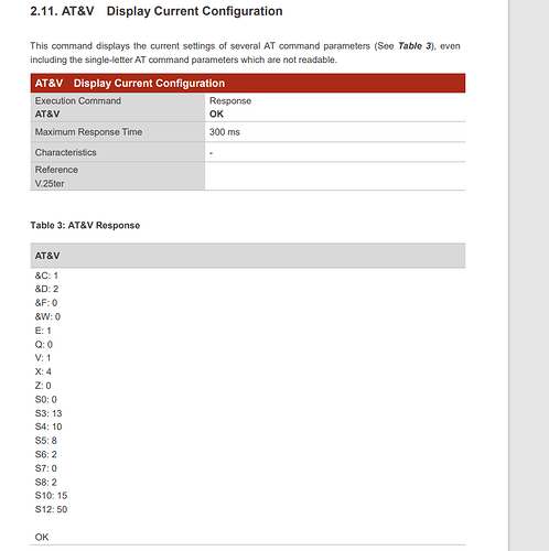

I have two eg25-g modules, Rpi 4b, base HAT, and T-mobile SIM cards. The Rpi config and software is identical but the two systems behave differently. If I swap the SIM cards, the problem follows the eg25-g. Is there a way to display or dump the complete eg25-g config settings so I can compare the two.
