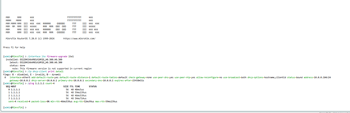

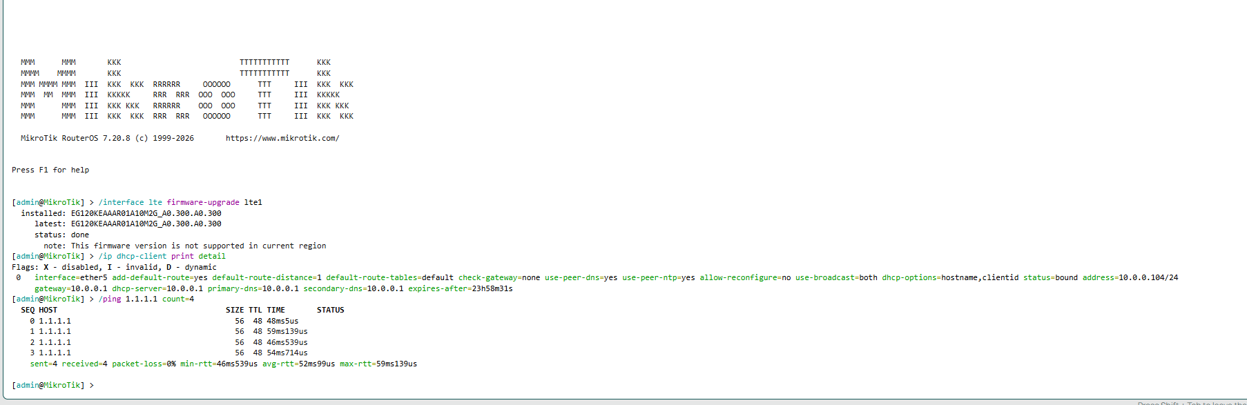

Hello. I have a MikroTik Chateau LTE12 with Quectel EG120K-EA. Current firmware: EG120KEAAAR01A10M2G_A0.300.A0.300 The modem cannot register on Russian MCC 250 networks and shows LIMSRV / No Service. Could you please send me firmware EG120KEAAAR01A10M2G_01.200.01.200 or another firmware version confirmed to work in Russia? Please also confirm whether downgrade from A0.300.A0.300 to 01.200.01.200 is safe for this modem. I also need the correct QFlash / USB DM procedure for MikroTik Chateau LTE12. Thank you.
Additional information: I provided the Chateau with working Internet access through Ethernet from another Yota router. The command: /interface lte firmware-upgrade lte1 successfully reaches the MikroTik firmware server and returns: installed: EG120KEAAAR01A10M2G_A0.300.A0.300 latest: EG120KEAAAR01A10M2G_A0.300.A0.300 status: done note: This firmware version is not supported in current region The router has confirmed Internet connectivity (DHCP bound and successful ping to 1.1.1.1). This appears to confirm a regional firmware restriction. Please advise which EG120K-EA firmware is supported in Russia / MCC 250 and whether downgrade to EG120KEAAAR01A10M2G_01.200.01.200 is supported.
