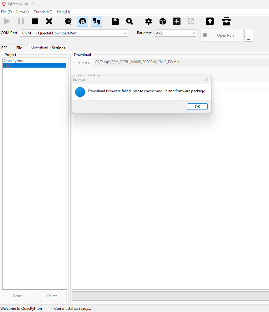

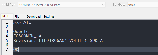

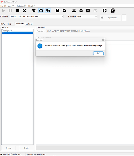

I’m trying to flash a new firmware onto an EC800M using QPYCOM, but the process keeps failing. When I start the flashing process, the USB port switches to the Quectel download port, but then nothing else happens. What could be causing this?
Hi,
Please check if the module model and firmware model are consistent
