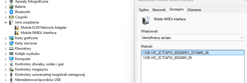

I look for drivers with allows me to contact with NMEA and ECM using Windows 11 system.
It is possible to connect with evalboard but no possible to read from ports NMEA and ECM with uart using.
Mayby you have drivers for USB\VID_2C7C&PID_6002&REV_0318&MI_00 ?
I heard that on linux all 4 ports are visible.

Hi,@darekpo
I have sent to you via private message,pls check

Hi,
It is works perfectly. I could read data on nmea port - it it wisible now correctly. Thank you once again.
