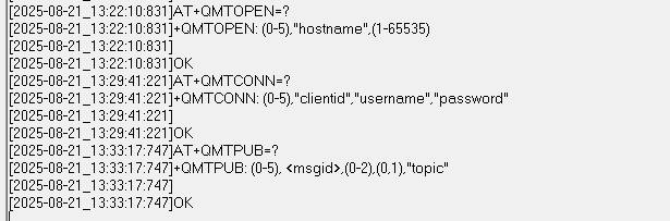

Hi ,
The latest version of the AT+CLAC command no longer supports it. I can’t test it locally.
Please provide the return value of AT+QGMR.
Also, please execute the following command:If you get the following return value, your version supports these commands.
AT+QMTOPEN=?
AT+QMTCONN=?
AT+QMTPUB=?

Yes, thank you so much
