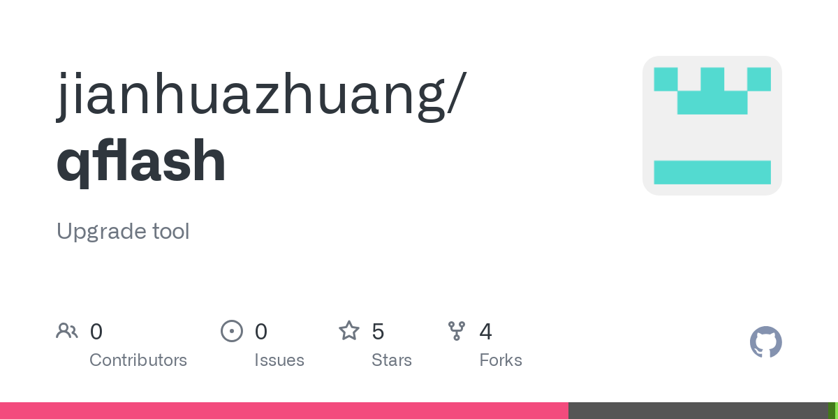

I’ve looked on the forums and people mention the QFlash tool, but I do not have it, could you please provide it?
I got this version of the QFlash tool through Github.
However, getting it through official Quectel means would be preferable, since this repository is over 2 years old.

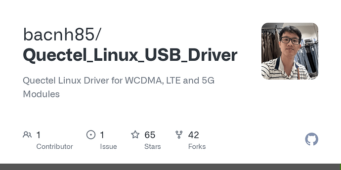

Should I replace option driver with this other Quectel driver? Where can I get it?
EDIT: I’ve found this other repository with a Quectel USB driver, however it’s last commit is dated late 2018.
EDIT 2: Code in repository above does not seem to compile properly, unfortunately. I’d appreciate if somebody gave me the right code.
