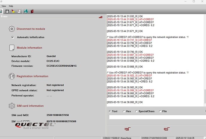

EC25-EUC does not work with RU sim cards
What can be done? Modem form factor llc, which firmware should be installed and how?

[2025-03-21 09:28:30:753_S:] AT+CFUN=0
[2025-03-21 09:28:30:817_R:] AT+CFUN=0
[2025-03-21 09:28:30:817_R:] OK
2025-03-21 09:29:11:767_S:] AT+CFUN=1
[2025-03-21 09:29:11:831_R:] AT+CFUN=1
[2025-03-21 09:29:12:070_R:] OK
[2025-03-21 09:29:12:480_R:] +CPIN: READY
[2025-03-21 09:29:12:480_R:] +QUSIM: 1
[2025-03-21 09:29:13:022_R:] +QIND: SMS DONE
[2025-03-21 09:29:13:721_R:] +QIND: PB DONE
[2025-03-21 09:29:40:492_S:] AT+CPIN?
[2025-03-21 09:29:40:552_R:] AT+CPIN?
[2025-03-21 09:29:40:552_R:] +CPIN: READY
[2025-03-21 09:29:40:552_R:] OK
[2025-03-21 09:30:07:504_S:] AT+CFUN?
[2025-03-21 09:30:07:583_R:] AT+CFUN?
[2025-03-21 09:30:07:583_R:] +CFUN: 1
[2025-03-21 09:30:07:583_R:] OK
[2025-03-21 09:30:29:792_S:] AT+CREG?
[2025-03-21 09:30:29:856_R:] AT+CREG?
[2025-03-21 09:30:29:856_R:] +CREG: 0,2
[2025-03-21 09:30:29:856_R:] OK
[2025-03-21 09:31:08:751_S:] AT+CEREG?
[2025-03-21 09:31:08:815_R:] AT+CEREG?
[2025-03-21 09:31:08:815_R:] +CEREG: 0,2
[2025-03-21 09:31:08:815_R:] OK
[2025-03-21 09:31:31:686_S:] AT+COPS?
[2025-03-21 09:31:31:750_R:] AT+COPS?
[2025-03-21 09:31:31:750_R:] +COPS: 0
[2025-03-21 09:31:31:750_R:] OK
[2025-03-21 09:31:50:163_S:] AT+QENG=“SERVINGCELL”
[2025-03-21 09:31:50:236_R:] AT+QENG=“SERVINGCELL”
[2025-03-21 09:31:50:236_R:] ERROR
[2025-03-21 09:32:13:319_S:] AT+CGDCONT?
[2025-03-21 09:32:13:382_R:] AT+CGDCONT?
[2025-03-21 09:32:13:382_R:] +CGDCONT: 1,“IP”,“”,“0.0.0.0”,0,0,0,0
[2025-03-21 09:32:13:382_R:] +CGDCONT: 2,“IPV4V6”,“ims”,“0.0.0.0.0.0.0.0.0.0.0.0.0.0.0.0”,0,0,0,0
[2025-03-21 09:32:13:382_R:] +CGDCONT: 3,“IPV4V6”,“SOS”,“0.0.0.0.0.0.0.0.0.0.0.0.0.0.0.0”,0,0,0,1
[2025-03-21 09:32:13:382_R:] OK

Your modem is most likely MCC locked due to sanctions. You typed at+qeng=“servingcell” with wrong quotes, try to type this command manually and chances are high you will find out it reports ‘LIMSRV’ state, which is an MCC lock sign. There’s no (easy/known) way around it.
What firmware does your device run (ati, at+cversion)?

[2025-03-24 09:20:50:745_S:] AT+QENG=“SERVINGCELL”
[2025-03-24 09:20:50:817_R:] AT+QENG=“SERVINGCELL”
[2025-03-24 09:20:50:817_R:] +QENG: “servingcell”,“LIMSRV”,“WCDMA”,250,20,6CB3,423CA32,10563,165,206,-81,-6,-,-,-,-,-
[2025-03-24 09:20:50:817_R:] OK
[2025-03-24 09:21:46:231_S:] ATI
[2025-03-24 09:21:46:302_R:] ATI
[2025-03-24 09:21:46:302_R:] Quectel
[2025-03-24 09:21:46:302_R:] EC25-EUC
[2025-03-24 09:21:46:302_R:] Revision: EC25EUCGDR08A02M1G
[2025-03-24 09:21:46:302_R:] OK
[2025-03-24 09:22:07:643_S:] at+cversion
[2025-03-24 09:22:07:722_R:] at+cversion
[2025-03-24 09:22:07:722_R:] VERSION: EC25EUCGDR08A02M1G
[2025-03-24 09:22:07:722_R:] Jan 18 2024 22:11:21
[2025-03-24 09:22:07:722_R:] Authors: QCT
[2025-03-24 09:22:07:722_R:] OK

Good day to everyone. There is a modem with EC25EUCGDR08A02M1G firmware. It does not work with the telecom operators of my country. Is there any way to change that? For example, by flashing.

@leon.bao , is the mcc lock is general position of Quectel?
Why firmware not operate in Russian region?
Hi,@Derweis_inc
I’m really sorry about this.I’m afraid don’t have.
@leon.bao If there is no firmware, then how to unlock it?
There is no way. Due to the US product control law, Quectel modules restrict Internet access in specific regions (Iran and Russia).
