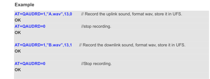

Please check why it will return “+QAUDRD:0” which means that Module is not in recording when you check it. Whether there have check the call state, the caller and receiver can hear the voice normally ?
And if you want to stop recording, it is better to use the command AT+QAUDRD=0 to stop it. But i can not see such command in your test log. Please double check it. And the following test example just for your reference. Please confirm it. Thanks!

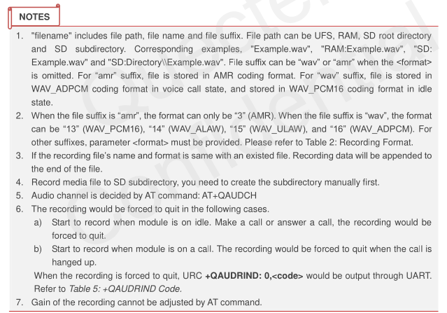

I don`t know why return “+QAUDRD:0”. And i force stop recording by ATH command accordingly note 6 in

As far as i know you use EC25 module right ? But why you will refer to GSM Audio Player Application Note ?
Please check the following right document and refer to the example in it. Thanks!
Quectel_WCDMA&LTE_Audio_Design_Note_V1.2_20170723.pdf (1.5 MB)
Thank you very match, Kyson. Everything ok.
