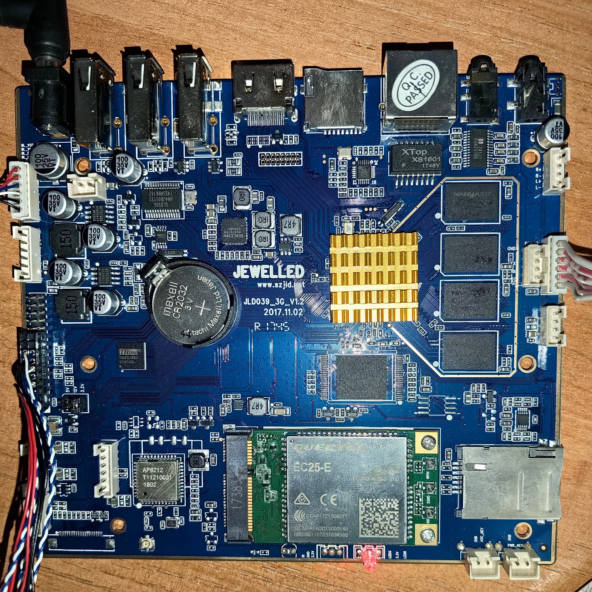

Hi everyone, I need help. I have such a device Jewelled JLD039_3G_V1.2, CPU Amlogiс AML8726-M8 4x ARM Cortex-A9 (32bit), Android 4.4. The EC25-E modem is installed in the miniPCIe connector on the board.
I downloaded the drivers Quectel_Android_GPS_Driver_V2.2.2_beta, and replaced files according to instructions:

But the device still does not see satellites.

Please tell me what I’m doing wrong? What parameters I need to write in the file gps_cfg.inf ? Thank you!
P.S. I checked the modem via USB adapter on PC by Qnavigator_V1.5 - it is configured, sees satellites and catches mobile network.
