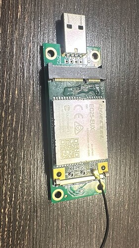

I have a module just EC25-EU GR
Photo module
