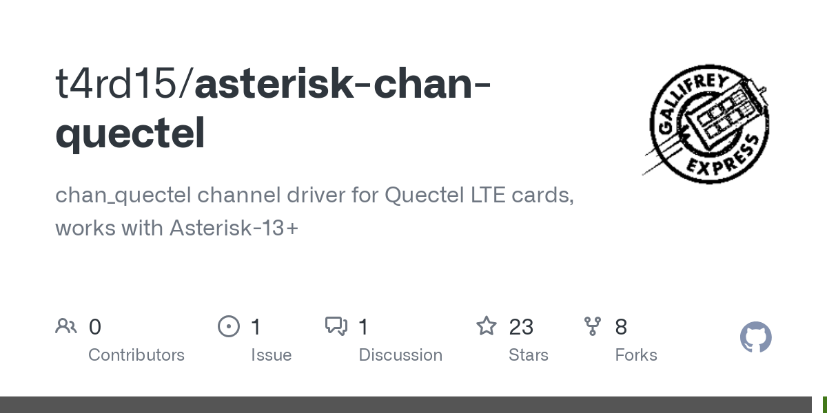

Working code for Quectel with Asterisk here GitHub - IchthysMaranatha/asterisk-chan-quectel: Asterisk channel driver for Quectel and Simcom modules, works with Asterisk-13+
