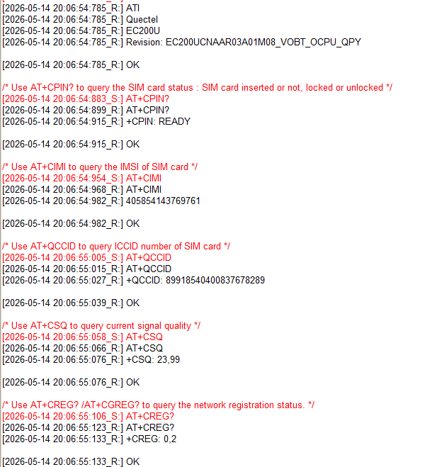

JIO sim is not getting registered with this firmware. For your reference I’m attaching a screenshot. Same is working with V04 QPY version from quectel download center
Could you please confirm this by referring to the steps below?

Dear @Felix.feng-Q,
It worked after I forced the network mode to LTE only. Before that, the module was not registering on the network. I’m not sure whether this is the intended behavior but thank you once again for your support.
