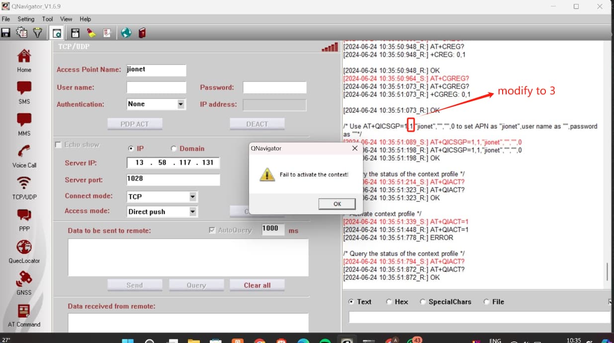

I can’t enable pdp for some reason , i have checked network registration using cgreg, cgdcont is also fine but qiact is giving error
Hi @drath
Can you change the IP type to IPV6 or IPV4V6?
Hi @drath
