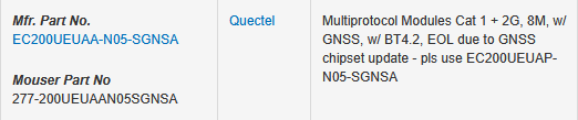

I just see a new variant for EC200U in Mouser:
which seems are replacing EC200U(EU/CN)AA-N05-SGNSA:
EC200U(EU/CN)AP-N05-SGNSA. The mouser suggests that this is due to GNSS chip upgrade. What is the difference between them in terms of GNSS chip? As I knew, the EC200U??AA are using UC6226 gnss chip. What chip does this new variant are using and what is the difference between these two?

Hi,
This is not a chip replacement, it’s a software version replacement.
The original software of the chip has increased compatibility and upgrade.
EC200UEUAC-N05-SNNSA& EC200UEUDC-N05-SNNSA: The difference is that they belong to different chip platforms.
