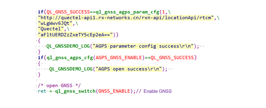

Module will automatically download AGPS data from server. Don’ t need custom socket.
It is simple to enable agps. Please refer to below screenshot.
