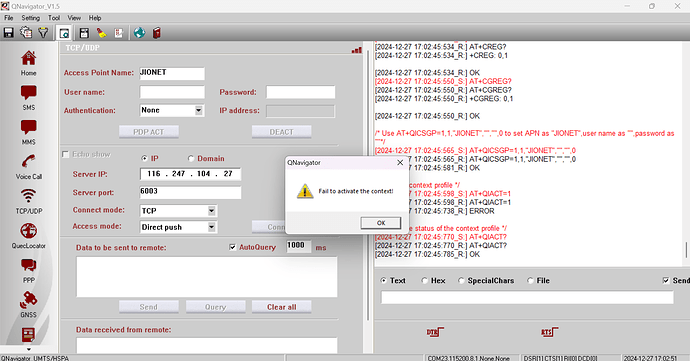

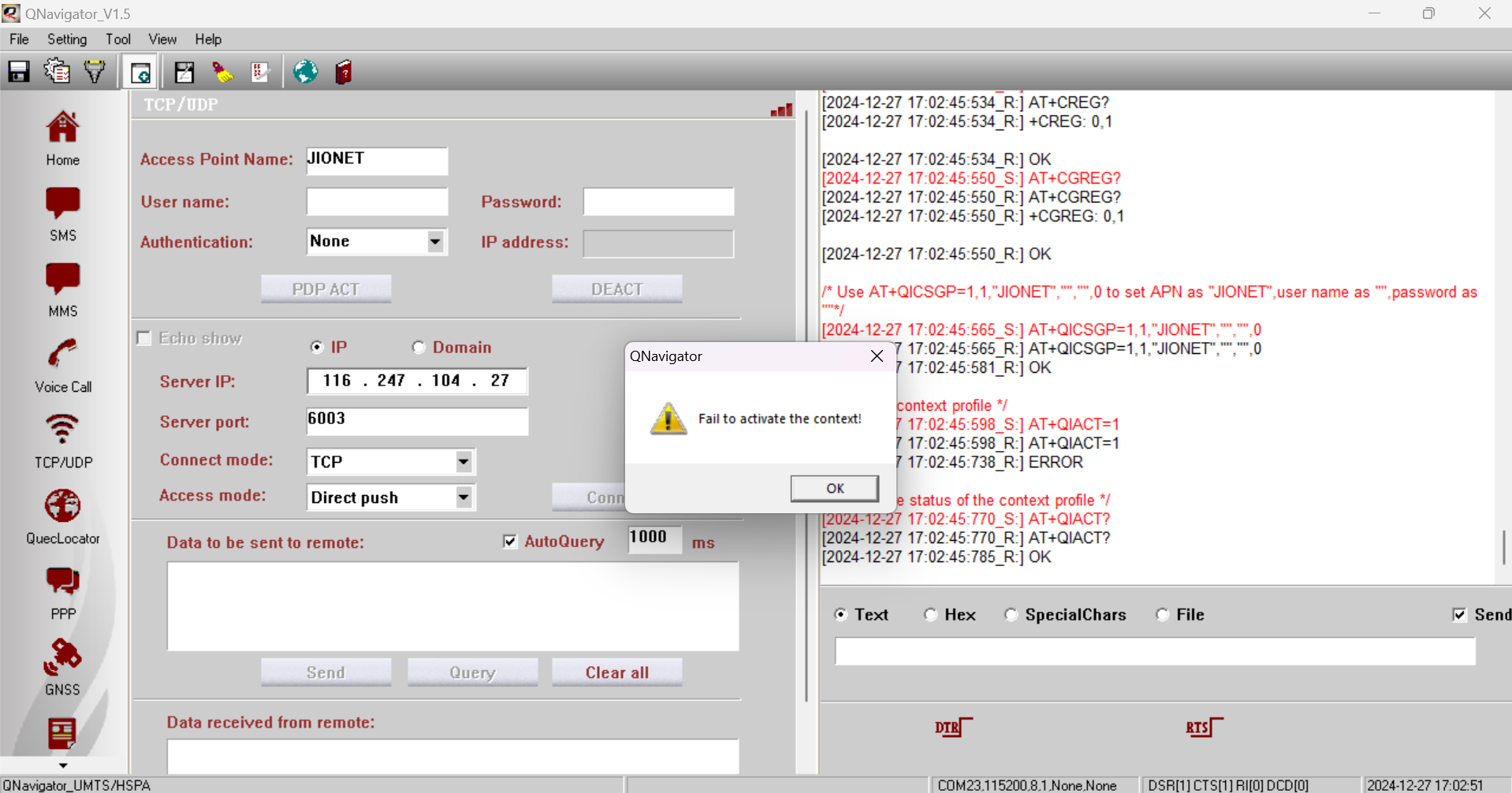

I am using 4G GSM EC200U-CN and i am using the sim card JIO 5G sim and there is an error when i select PDP ACT option which is “Fail to activate the context”. Since i am using jio sim card i have access point name given as JIONET.

I have done according to the steps but i still get the error. These are the commands:
AT+QCFG=“dftpdn”,1,“JIONET”,0
OK
AT+QICSGP=1,1,“JIONET”,“”,“”,1
OK
AT+QICSGP=1,1,“”,“”,“”,1
OK
AT+QIACT=1
ERROR
