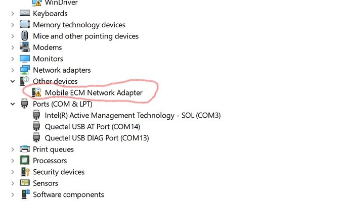

I have installed EC200T driver as your link, but my PC do not find Mobile ECM Network Adapter. Can you give me this ECM driver ? Thank you in advanced.
you’ve got to change the usb interface of the modem from ECM to RNDIS which is the usb interface used in windows.
In order to do that, you have to send the AT+QCFG=“usbnet”,3 AT command to the modem.
@Mahdi_Joodi thanks.
@thanhtinbk yes, ECM driver is not yet available, please switch to RNIDS mode, rndis driver provided by windows system.
