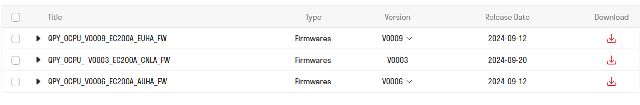

I’m working on a Quectel EC200A-EUV1 module, and I need to use QuecPython on it, the issue is when I use the firmware available on the download section from QuecDevZone (QPY_OCPU_V0009_EC200A_EUHA_FW), ATI > Revision : EC200AEUHAR01A09M16_OCPU_QPY (no V1 in designation), I lose registration capacity on LTE networks, and since the standard firmware for the EC200A-EUV1’s Revision : EC200AEUV1HAR02A06M16 has the V1 in it I thought maybe I need the a specific OCPU_QPY firmware with the missing V1 in designation.

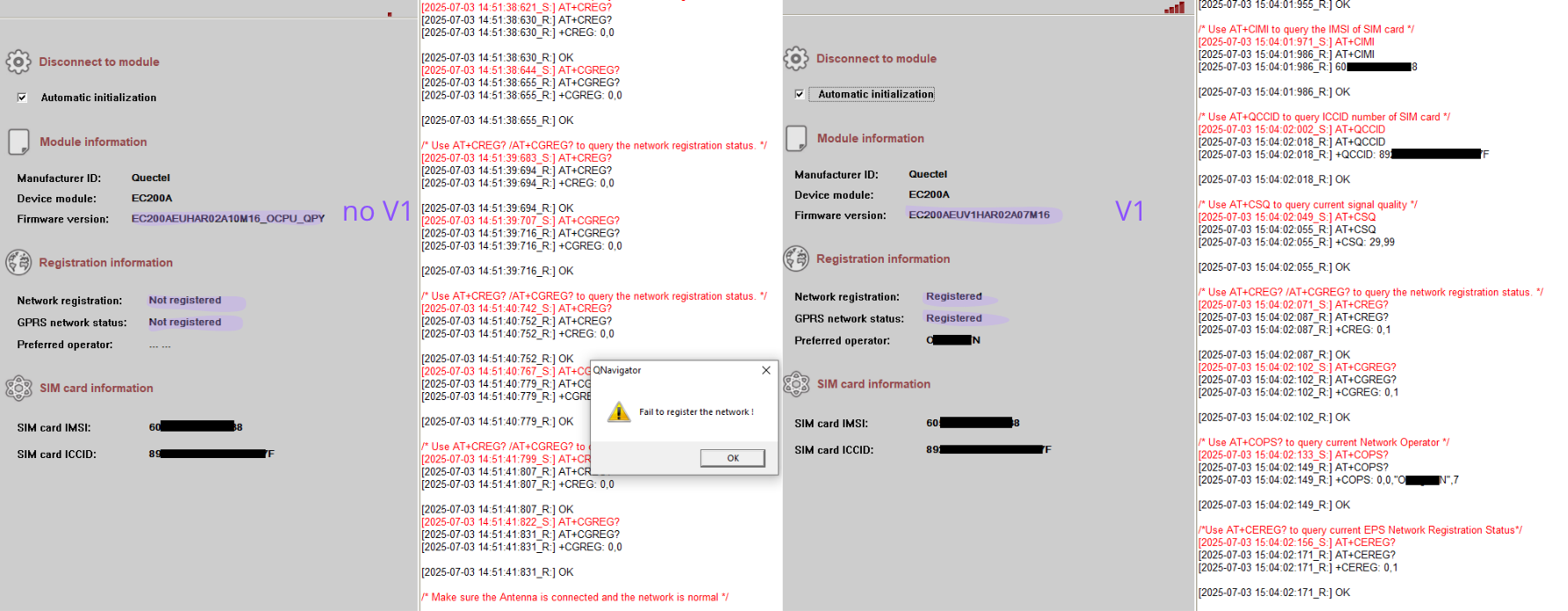

Thank you herbert, I received and flashed the firmware you have provided but my problem persists, I can register to networks using the EC200A-EUV1 standard firmware (EC200AEUV1HAR02A06M16) and no regsitration on the OCU_QPY one (EC200AEUHAR01A09M16_OCPU_QPY) which I think is for EC200A-EU and not EC200A-EUV1.
Here are some QNavigator screenshots to further understand the issue.
