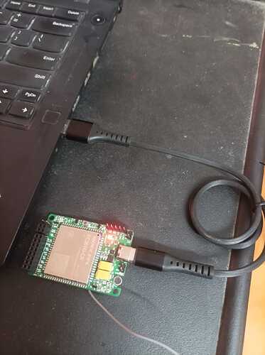

we have install the driver eventhough the this mode doesnot show in device manager. additional y we have given 5 v external supply given still same issu
kindly help for short out for this problem.
Thank you for the update.
Since the driver is already installed and the module is powered with an external 5 V supply but still does not appear in Device Manager, this is likely not a driver issue.
Can you please help check the following:
-Use a USB data cable (not a charging-only cable)
-Try a different USB port or PC
-Observe any LED indication on the module after power-up
If possible, please share:
-A photo of the hardware connection
-LED status after power-on
This will help us narrow down the root cause quickly.

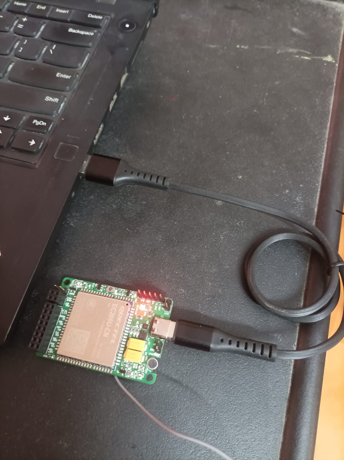

Dear sir
we have connected the external power supply 5v/4A and also 1Gpbs data speed cable connected .
But board is not detected. what is the issue now
kindly help us to resolve it

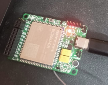

Here only Reset key is available, there is no pwrkey button. I have pressed the key 2-3 sec, but the module is not detect in PC
Hi Joesara,
I just saw your earlier reply regarding the module. It turns out that you are using an EC200U-CN module, but you requested EC200A-EU firmware. These two modules use different chipsets, so the associated drivers are also different.
Could you please help to capture a photo of the module label showing the IMEI clearly? I can then trace which firmware was originally flashed on the module.
