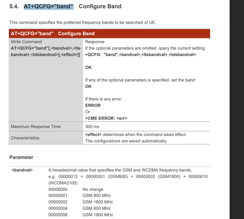

hi there,
Have you try to lock the band using the command AT+QCFG=“band” ?
