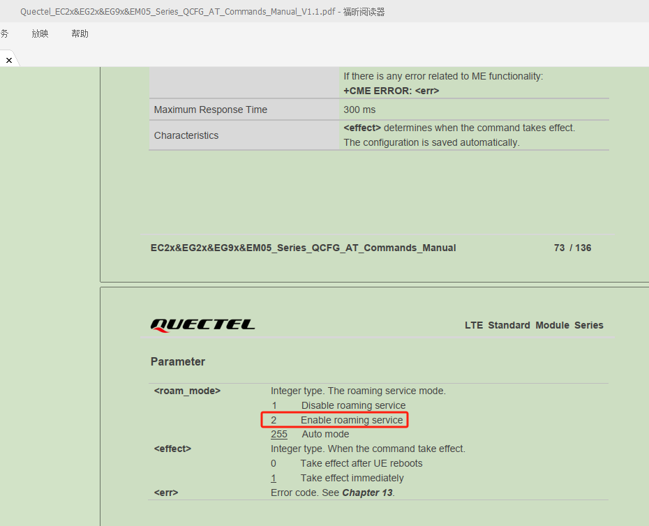

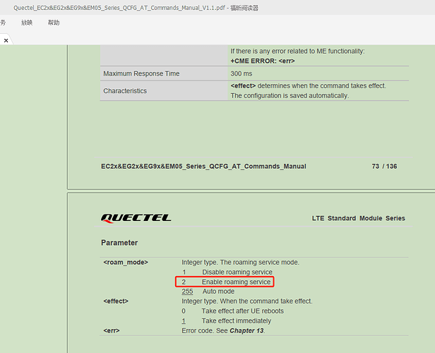

Hi @jacol
It is recommended to set it to AT+QCFG=“roamservice”,2
