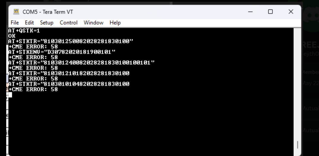

Hi Mikey,
iam also facing the same issue when tried to switch the profile in esim . iam attaching the at commands shared by the esim vendors for profile swiching but when i send the at commands it is showing CME Error 58
