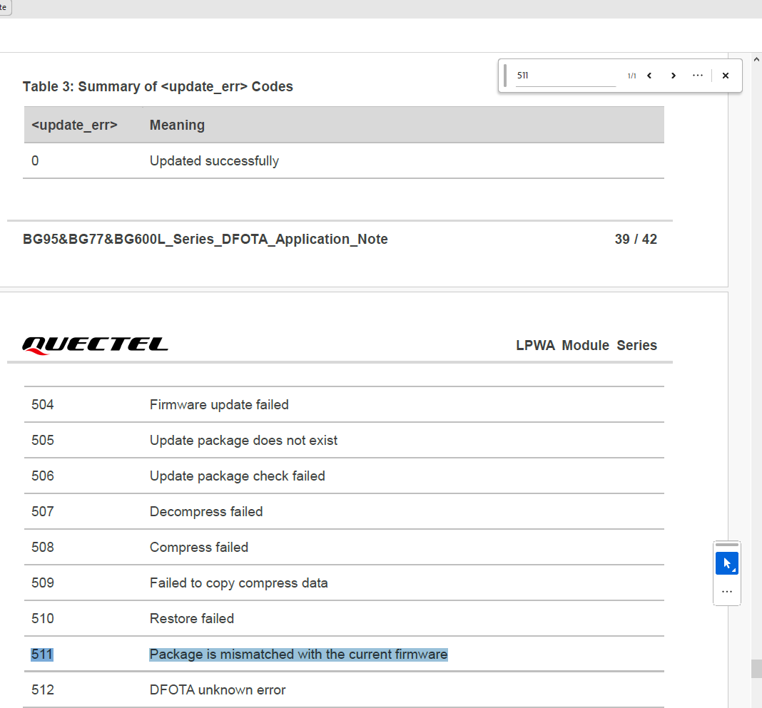

Hello I’m having some problems while updating BG95-M3 while doing DFOTA update.
I’ve already asked to FAE binary file. In some devices the update process work but there are a number of them that abort the process returning error codes.
The documentation is not clear with the user at the moment while the module returns for example:
511: Package is mismatched with the current firmware
Can I ask for a document to follow steps base on error codes for DFOTA procedures?
At the moment, I’m running DFOTA from version:
BG95M3LAR02A03_01.006.01.006 to BG95M3LAR02A03_A0.206.A0.206

The most likely reason for this issue is that the differential package does not match. You can remake the differential package and try again.
I could represent the issue by trying to download a DFOTA package from v6 to v206 failing. After that I tried to download a smaller package from v6 to v17. This download finished successfully but returns 511 error.
How can I erase all previous download information/configuration to start from scratch?
I’ve more than one module that could update successfully with this package, so I think that it’s a configuration feature that I missed.
