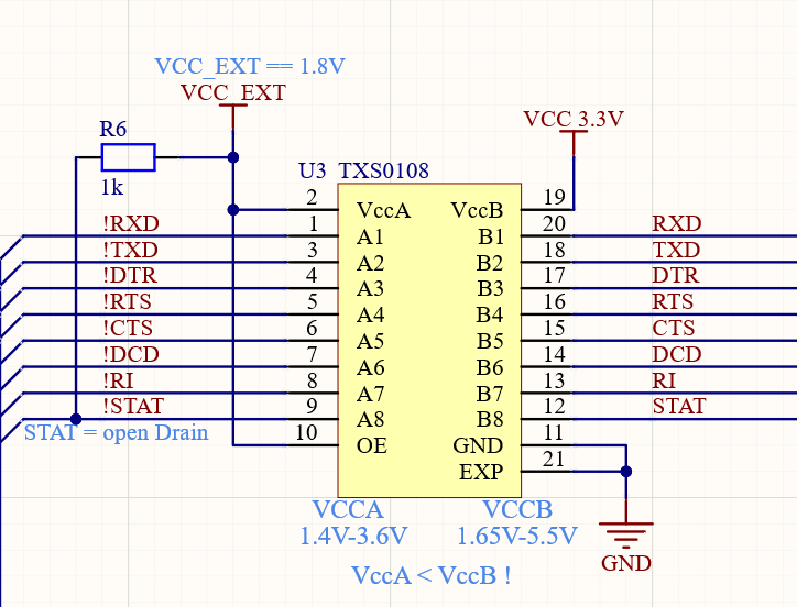

Hallo, i am also havin trouble to set the module in Sleep mode via DTR Pin.
The module is only connected via its IO Pins, no USB.
Using a TXS0108 as level converter as in Datasheet, all communication works fine at highest Baudrate etc.
AT+QSCLK is configured to 1.
But DTR Pin on Modem stays 0 when Host setz is high. Seems to me that the EC25 forces the DTR Pin state low. Did I Miss Something? Module DTR Pin is a simple Input? Right? In order to put Modem in sleep mode, do other Module Pins need a certain state?
