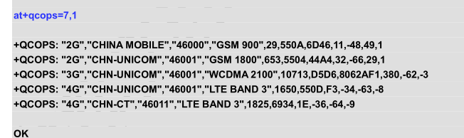

Just as you have said that you want to understand which is the best operator available, i recommend you try the following AT command, which can list all the Current Available Networks. Hope it is useful to you. Thanks!

[2019-07-23_17:50:42:986]AT+QCOPS=7,1
[2019-07-23_17:50:42:986]ERROR

Dear Sir,
Please check the following test log in my side. i think we use different Firmware. So please check with our local FAE who support you to check it. Thanks!
