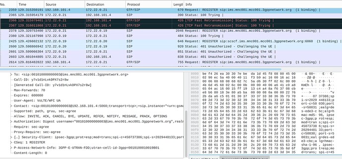

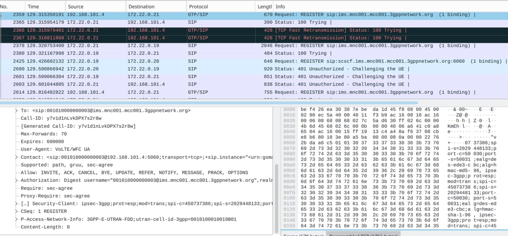

Right now, we’ve other problem related to the connection from the AG566N to the IMS infrastructure (Kamailio in this case). The problem indeed is that the device is always sending a SIP REGISTER to Open5GS and never stops. I attach you a picture with the problem in the hope this helps you because we’re stuck in this process and we don’t have so much experience with this kind of services.
Maybe someone can help me with this problem.
Thank you so much in advance!
