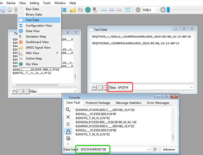

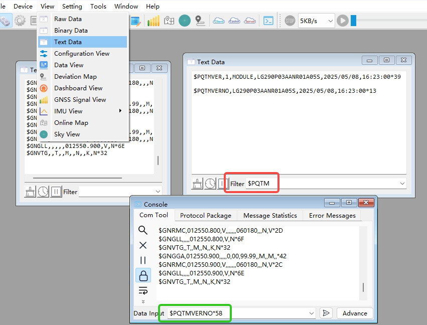

I am assuming you want to use a filter to filter our certain commands from the NMEA messages. You can use the Text data window to filter the desire responds command.
The green box shows the command you want to send and the red is the filter for the expected responds.

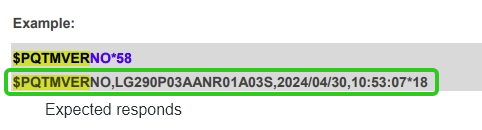

For future commands, the GNSS Protocol contains documents of command example, you will have to check and analyze which wording to use for filtering as shown below
