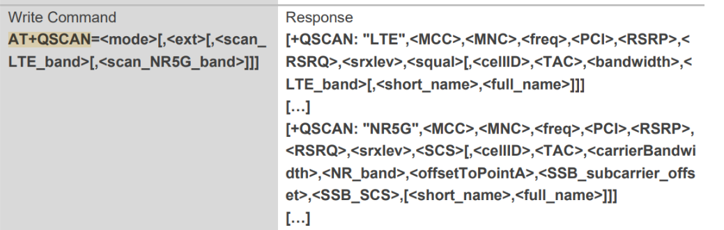

Cell ID output in at+qscan
Based on the bit length of the cellID values, my understanding is that it maps to the NCI in 5G and to the ECI in LTE. Could you please confirm? Thank you!
Yes, your understanding is correct.
