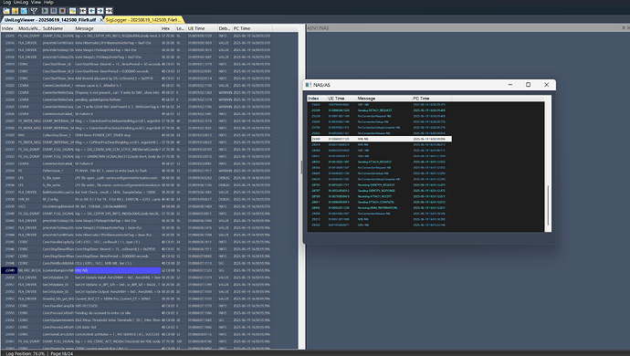

Now the issue is that, while i can capture logs, I cannot export logs to wireshark pcat format. And I’m not even able to see the message details in ANS1 window. I think the two issues are connected… maybe some plugins!
FW version: BC660KGL AAR01A05_01.203.01.203

Could you provide the captured EPAT log? Firstly, you might not have installed wireshark. Secondly, you might not have established any protocol stack and there is no data packet output
es sure.
WireShark version 4.4.6 is installed and was running.
Attached the log and a screenshot of the log windows, where you can find protocol stack and messages present, but no ASN1 info are present.
pls add a PING service
AT+QPING=0,“8.8.8.8”
then you export the pcap and check
