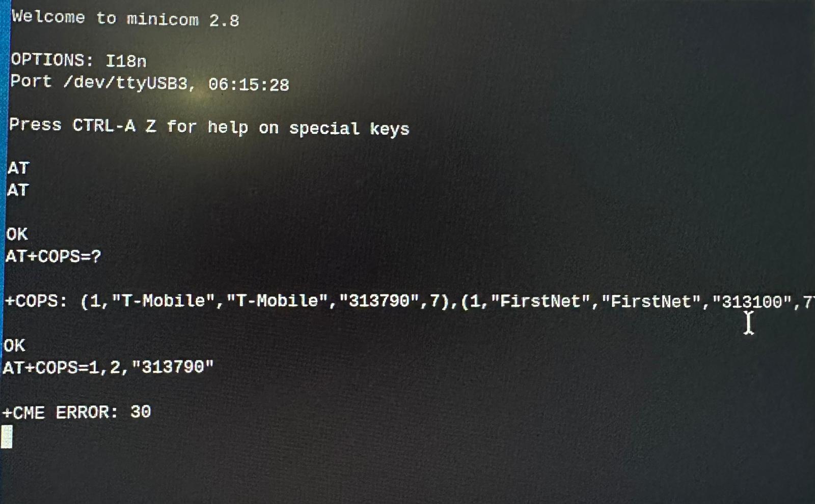

Hello everyone,
I’m trying to connect a Raspberry Pi W2 to a module that includes a Quectel RM502Q-AE, but I’m encountering some issues. When I run the AT+COPS=? command, I can see available networks, including T-Mobile (313790) and FirstNet (313100). However, when I attempt to manually select a network using AT+COPS=1,2,"313790",7 or similar variations, I keep getting an error.
I’ve also tried setting automatic network selection with AT+COPS=0, but I’m still facing difficulties.
Dear @Stryker180
AT+COPS=? was serching th额network.
But you should mark sure your SIM card was allowed to register on these network.
