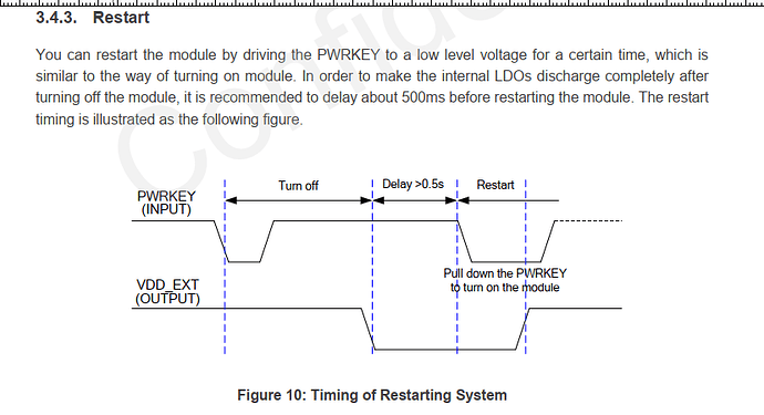

I am trying to reset a M66 modem using the power key. It seems the modem is shutting down (as I do get a NORMAL POWER DOWN urc), but after that I cannot turn it back. Here the POWER KEY GPIO toggle timing.
Note: I am using STM HAL Library, but the code is pretty standard, its just toggling the PIN HIGH and low. Am I doing something wrong with the timings?

M66 does not support reset function. If reset is required, shut down through PWRKEY and wait for more than 500mS before restarting.
