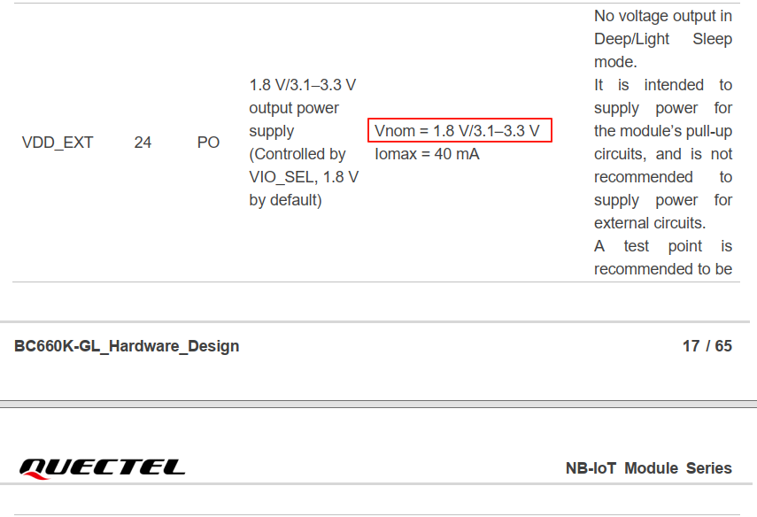

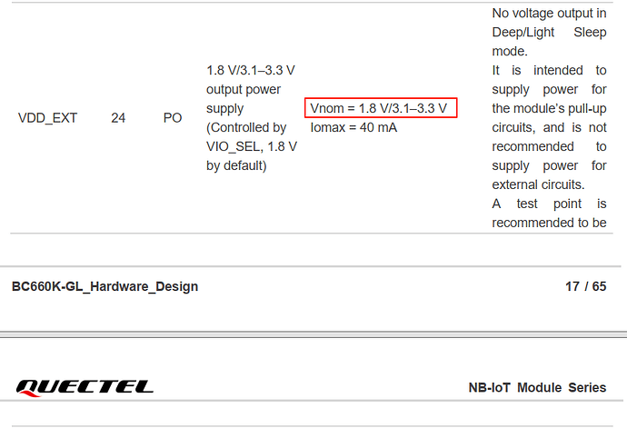

If your BC660K can operate normally AT during working conditions, I think this issue might be caused by an unreasonable pin design of VDD_EXT
