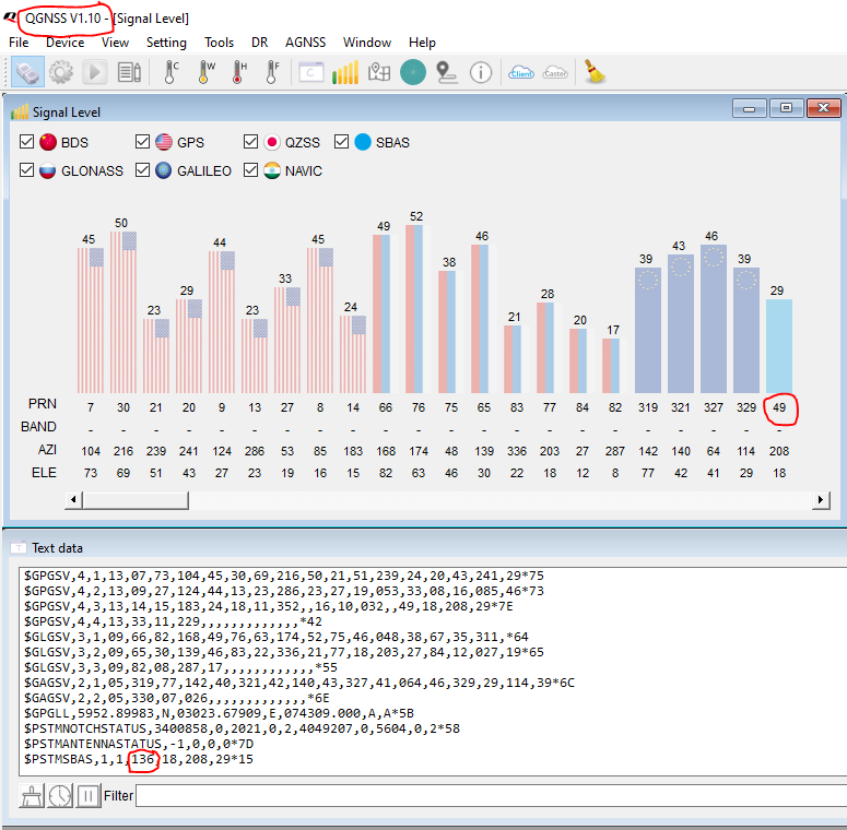

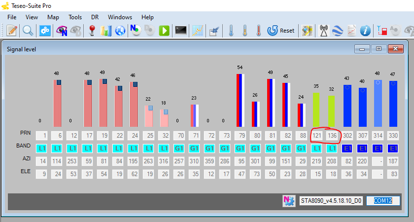

I discovered a bug in the QGNSS v.2.2 program - decoding the SBAS satellite identifiers (PRN) incorrectly. However, the identifiers (PRN) in the NMEA messages are correct. I’m also attaching a screenshot of the Teseo Suite program, where the identifiers (PRN) are decoded correctly.

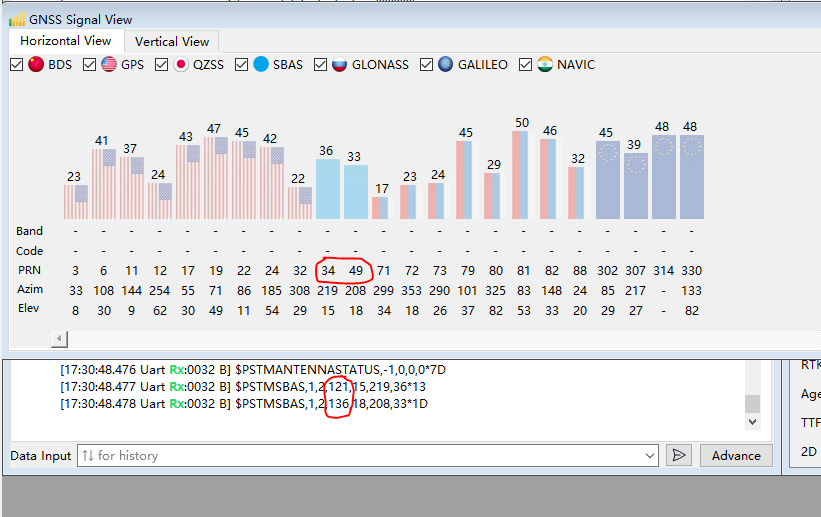

I will also send you another version of QGNSS to see if this issue occurs via email

Hi, YongHuang!
1 - L26T-S89
2 - L26TNR01A06V02
3 - my own design
Also I see same problem with SBAS satellite identifiers (PRN) on QGNSS v.1.10…

In PSTM, the private sentence PSTMSBAS displays PRN as 136. However, in the standard NMEA protocol, there is no PRN 136. The actual PRN in NMEA is 49. The private sentence applies an offset of 87 to the raw PRN value.
  • The NMEA PRN can be seen in the GSV NMEA message, which follows the standard format.
  • The PSTMSBAS PRN shown in the private sentence is the raw PRN from the satellite, before any offset to NMEA standards.
The tool being used is a general NMEA parser, designed for modules that support the standard NMEA format. Therefore, this behavior is not a bug in the tool.
For interoperability and consistency, always reference the NMEA PRN (e.g., 49) when working with standard NMEA messages. Which falls between 37 - 64
